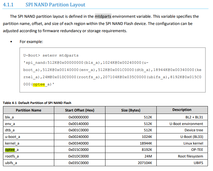

  • Hi TaeJung,
    SDK 1.4.1 is supported, but for SDK later than 1.4.0, you will need to have OPTEE in your firmware to boot your KL730.

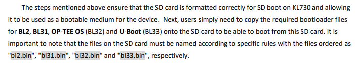

  • Hi TaeJung,
    Yes, inside the SDK/01_BSP/01_Document/KL730_Development_Environment_User_Guide.pdf, in Section 8.5 SD Boot, it says that you will need the OP-TEE OS for your SD card.
    Please refer to the above documentation for more information on SD Boot and OPTEE. Thank you!
