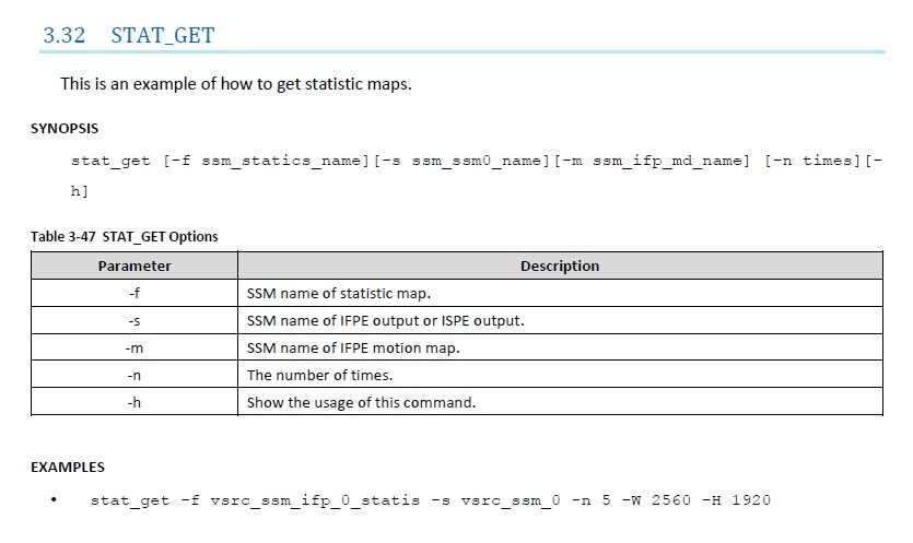

    To retrieve the focus statistics, you can use the 'STAT_GET' example. Please refer to the instructions in Section 3.32 of the Leipzig_SDK_Examples_User_Guide.pdf.

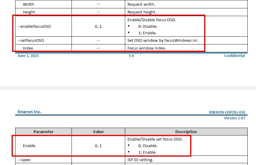

    Additionally, there are focus-related settings available in 'streamer_msg_sender –C 2'. Please refer to < 3.1.1 Message Sender > for more details.
