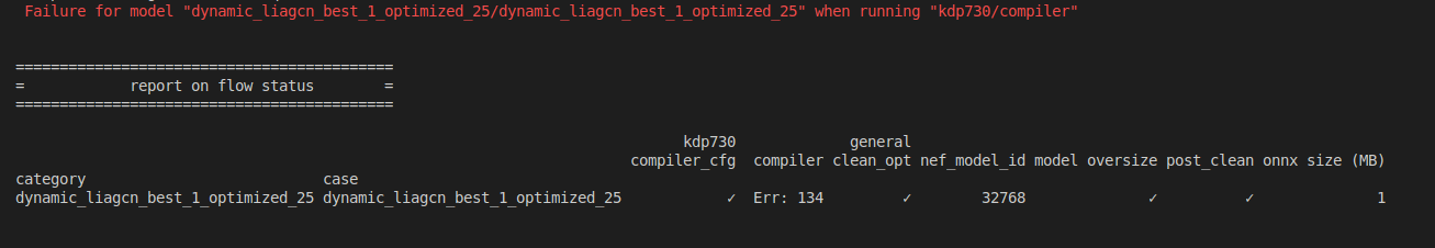

I am currently converting a skeleton-based action recognition model (LIAGCN) for the KL730. While the initial optimization stages complete successfully, the process fails during the BIE conversion with a hard assertion error in the compiler.
Error Stack Trace:
