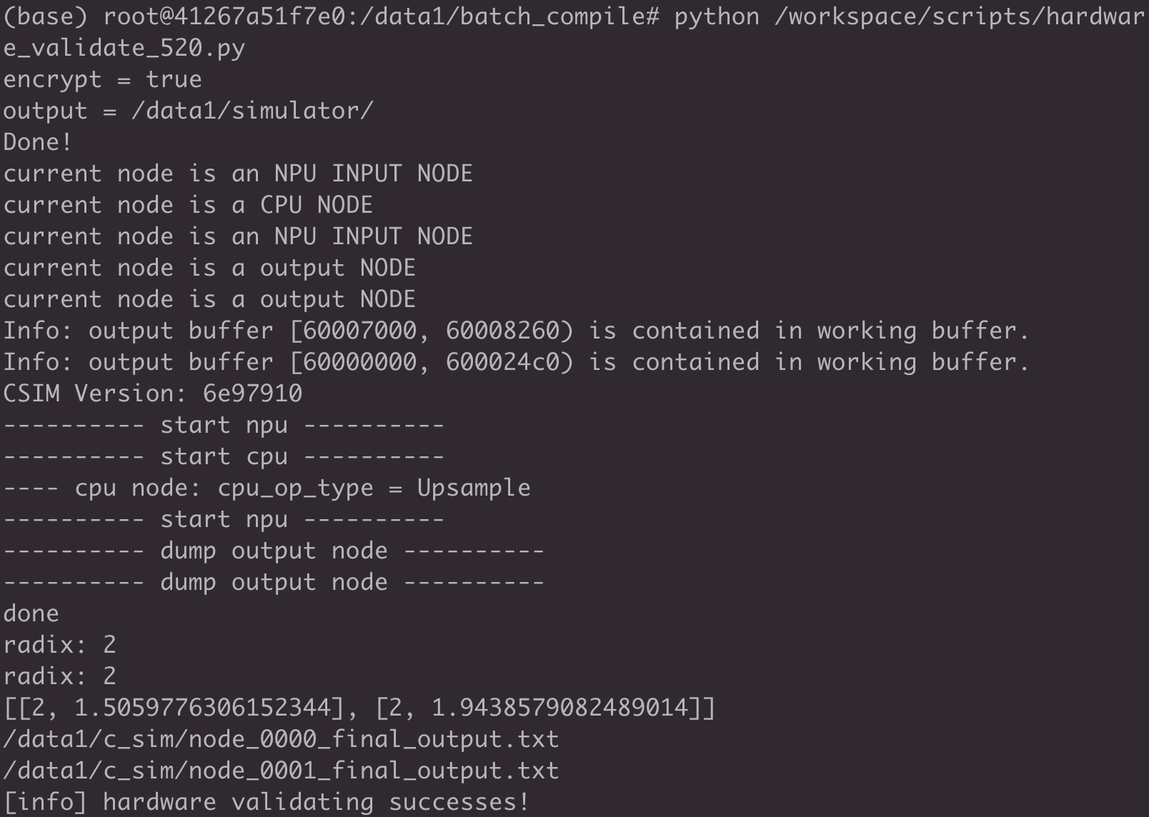

But after running /workspace/scripts/fpAnalyserCompilerIpevaluator_520.py and /workspace/scripts/hardware_validate_520.py, the result of hardware validation shows the radix=2.
How can I actually set the radix to 8?
Thanks.
Actually, the radix with your setting is 8.
There are different radix in each layer, and the radix: 2 in log means the radix of last layer. Please disregard the number.
In your case, you set the parameters "img_preprocess_method": "kneron" and "radix": 8, with the radix formula: 7 – ceil(log2 (abs_max)), your model would be quantized by radix = 8.
