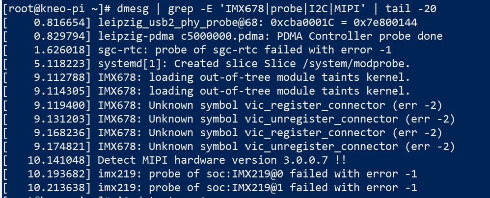

IMX678 on KNEO Pi - IMX678.ko loads but probe fails + missing VIC symbols
I'm trying to use an IMX678 camera on KNEO Pi. I have copied the IMX678.ko files to the modules directory and loaded it, but I'm getting the following errors:
I have the following files:
imx678_3840x2160_ch0.cfg
LSC bin files
Resource folders (AE, AWB, ISP, VIC, etc.)
Command uname -r returns:
6.1.0-1
Command ls /lib/modules/ returns:
6.1.0-1 7.1.1-1-aarch64-ARCH
Questions:
1. Do I need additional VIC / ISP kernel modules? (I only have IMX678.ko)
2. What is the correct loading order?
3. Is there a specific config needed for IMX678 on KNEO Pi?
4. Can you provide the complete driver package for kernel 6.1.0-1 (or 7.1.1)?
5. Is there any required power-up sequence or GPIO config for the IMX678 on KNEO Pi?

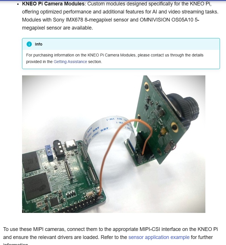

I couldn’t find the exact option shown in the picture you provided on the Development Center page. Could you share the download link, or confirm whether the one below is the same?
To reach the SDK of KL730, you need to get the permission priorly.
Please contact your purchase window to get the authority of access.

The screen shot you posted is our Document Center, there is lots of corresponding information of usage but there is no file there. Please download files from the Developer Center. And all corresponding KL730 documents are included in the KL730 SDK file.

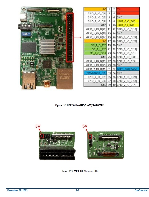

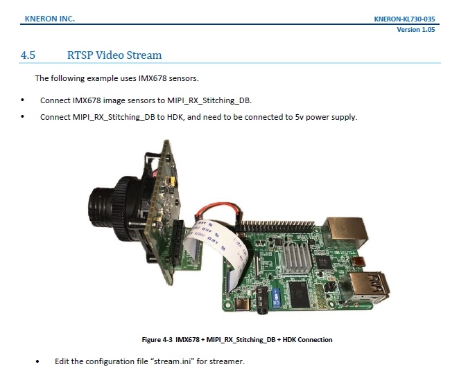

We have checked the camera connection, and it looks fine, but the guides we have don't show the power connection in detail and we only know where to connect the 5v line. We need to provide 5v and GND and the camera board has 3 pins, could you provide a picture or instructions showing which pins we need to use? Also, any other possible cause and/or instructions are appreciated.
If you are using KNEO Pi Camera Module, you need to connect the power of camera sensor on your own. Please follow the instruction of section "KNEO Pi Camera Modules" to connect the cable.
And you can refer to the page below to check the pinout.
By the way, you can find more details on the document "KL730_HDK_Board_User_Manual.pdf". Figure 2-2 and Figure 2-3 show the pinout of board HDK and sensor board.
Section 4.5 <RTSP Video Stream> shows the board connection instructions.
