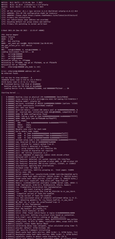

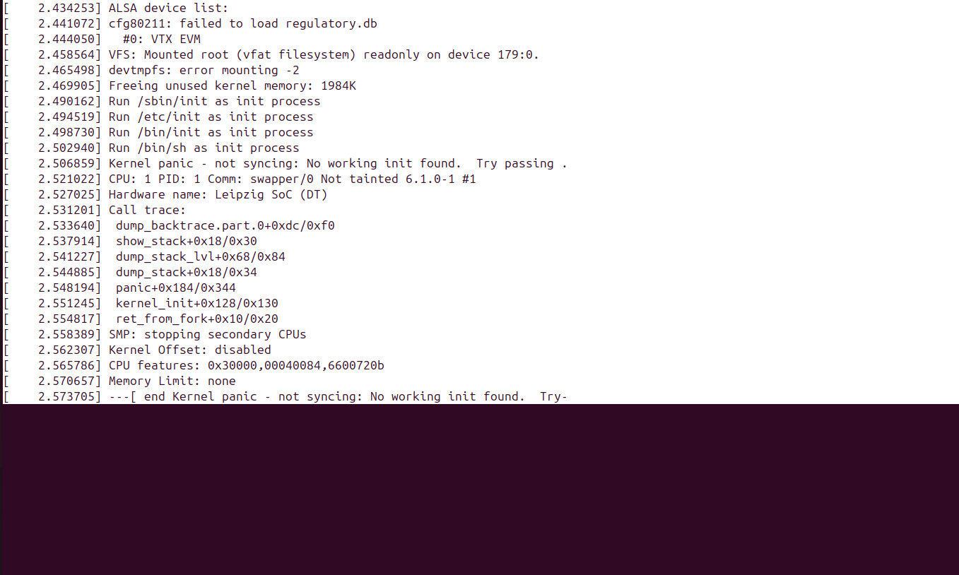

I have followed all the steps mentioned above and used the
uboot.envfile you provided. I have also followed the manual step-by-step. The U-Boot configuration and the other steps appear to be working correctly, and I am able to load the kernel image from the SD card.However, I am still facing an issue while loading/booting the root filesystem (
rootfs). The system is not able to boot the rootfs successfully.My requirement is to boot the complete system entirely from the SD card, including the kernel and rootfs.
I have attached the exact UART logs from my latest boot attempt for your reference. Could you please review the logs and help me identify what is causing the rootfs loading/booting issue?
In particular, could you please advise:
I have attached the UART logs showing the exact issue. Please let me know what changes I should make and how we can proceed from here.
Thanks for your support.
I added commands for loading rootfs and confirmed the result.
Here are the commands and the uboot.env for your reference.
baudrate=115200
bootdelay=3
bootcmd=fatload mmc 0:0 0x800000 Image; fatload mmc 0:0 0x2A00000 leipzig.dtb; fatload mmc 0:0 0x7400000 rootfs.squashfs; booti 0x800000 - 0x2A00000
bootargs=console=ttyS0,115200 root=/dev/ram0 initrd=0x7400000,32M ramdisk_size=65536 earlycon
