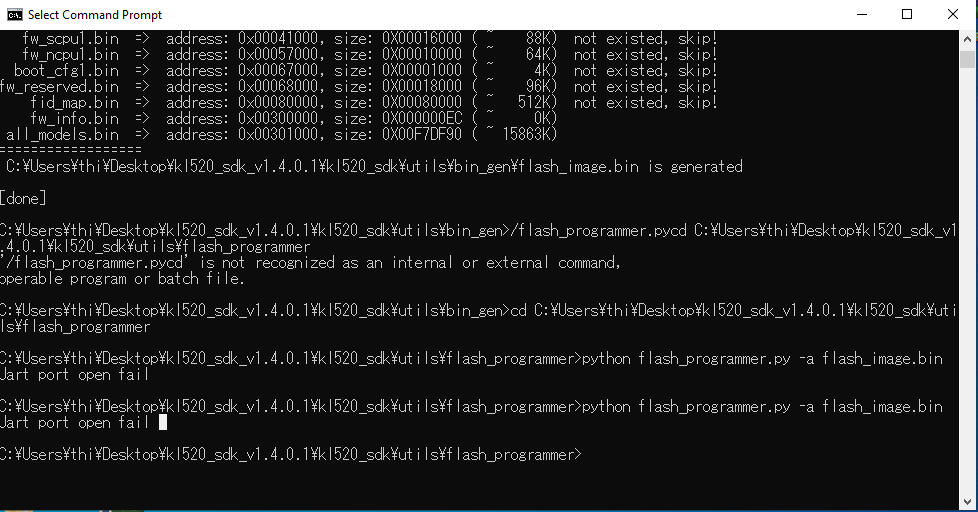

I'm following intruction http://doc.kneron.com/docs/#520_1.4.0.0/getting_start/#10-flash-programming. However, when i type command "python flash_programmer.py -a flash_image.bin":
How can i fix it?
do you have use other program show board log?
if you have use other program show message, please help me close.

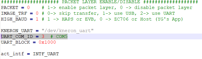

and check setup.py UART_COM_ID = 3 # COM5 is it right or not.
It worked. Thank you for your support

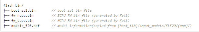

Can i ask you that, where can i get 2 files fw_ncpu.bin and fw_scpu.bin? And "generated by Keil", what does it means?
i took it from \host_lib_v0.9.1\host_lib\app_binaries\KL520\tiny_yolo_v3, but when flash program into KL520, it just show little codes and nothing display on screen.

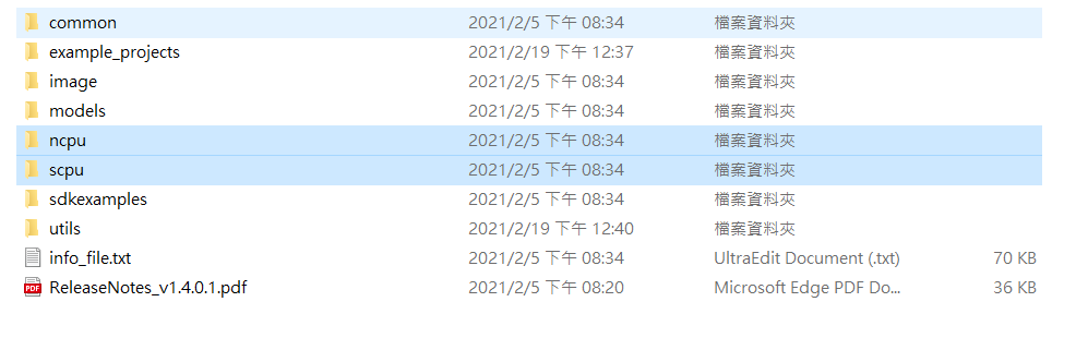

please took from kl520_sdk_v1.4.0.1 below pic, fw_ncpu.bin is ncpu folder, fw_scpu.bin is scpu folder and generated by Keil.
Sorry, I still can't find it. Is it available or do i have to build it by myself?
