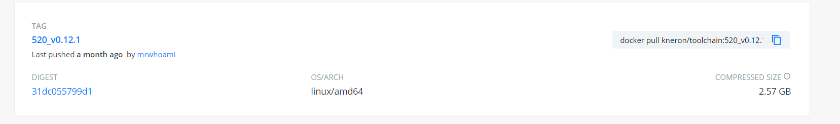

maybe the problem is "a_group_min_scale <= 1000" but i can't find any about this param.
could you help me downgrade toolchain? thanks.
I followed the problem "[Example][Keras][KL520] How to convert and compile tiny-yolo-v3 from github project" to solve it, thx
