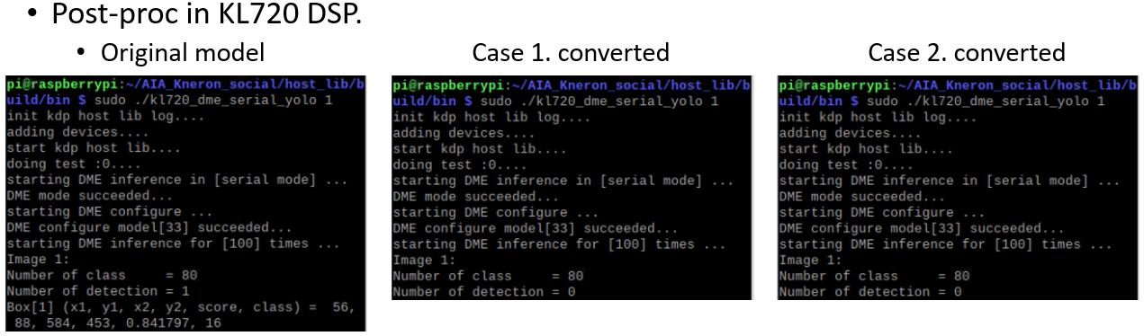

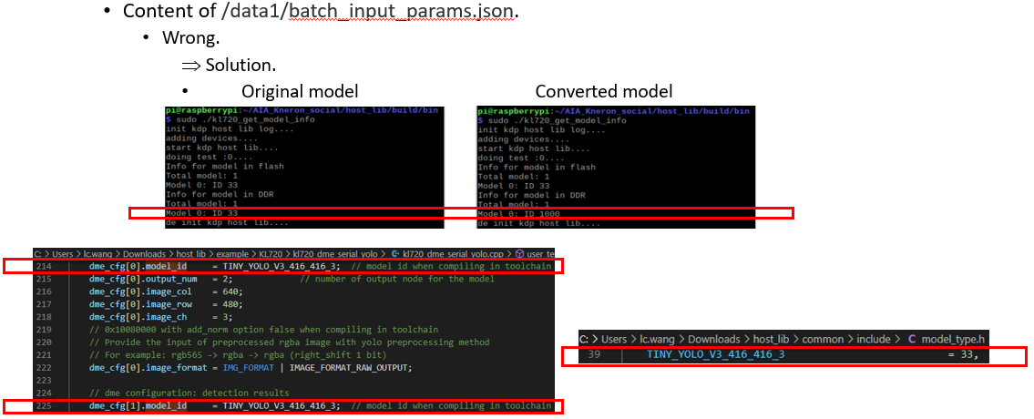

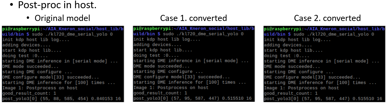

Model conversion and test:
Case 1.
  1. Follow up http://doc.kneron.com/docs/#toolchain/yolo_example/, and change the model to yolov3-tiny in step 1, 520 to 720 in step 2 & 3.
  2. Successfully convert to models_720.nef and transfer to Rbp4B.
  3. Run original model successfully that verify connection is OK.

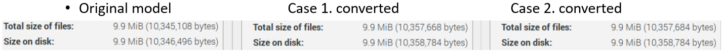

  4. Replace with converted model in folder /home/pi/AIA_Kneron_social/host_lib/input_models/KL720/yolov3_tiny_416.
  5. Run.
=> Fail.
Case 2.

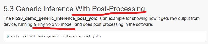

  1. Follow up https://www.kneron.com/forum/discussion/53/example-keras-kl520-how-to-convert-and-compile-tiny-yolo-v3-from-github-project, and change 520 to 720 in step 8.
  2. Successfully convert to models_720.nef.
  3. Others are the same as Case 1. It still fail to run.
Please help me.
