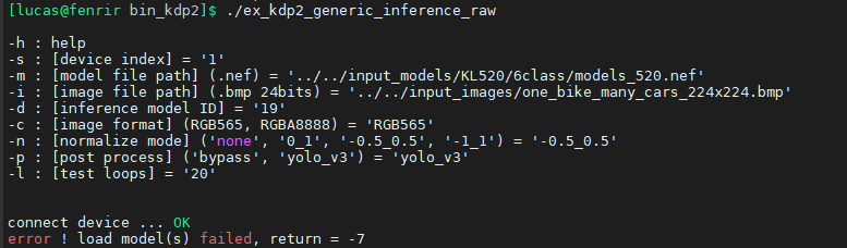

Hi, I created the model_520.nef, so now I'm trying to use this model to make inferences.
I try to use generic inference raw:
Giving me this error,
I would like to know the steps to load this model in to the KL520 to make inferences,
Thanks!

  • It seems the firmware system got something after load your NEF model.
    How many models in your NEF file? Is any model with model_id 19 in the NEF file.
    And how large your NEF file is?
  • Hi,
    I create the NEF file after converting one ONNX model following the Toolchain Manual.
    I try changing model_Id to the one I used doing the Toolchain Manual, but still doesn't work. Doesn't model_id 19 belong to tiny yolo v3?
    The NEF file is 88 Kb large.
    I also tried running ex_kdp2_tiny_yolo_v3 and ex_kdp2_update_firmware, but there was no response, I just waited while nothing happened.
    Is there a way to reset the firmware or is there another way to fix this?

  • Yes, the model_id 19 is for Kneron's tiny yolo v3 example. But the NEF is just 88Kb, so I guess the model you generated is not tiny yolo v3.
    Was the NEF file generated by command "fpAnalyserCompilerIpevaluator_520.py" and "batchCompile_520.py".
    Because of there are two types of chip in toolchain, users should confirm the device they are using.
    Are you using the dongle of KL520? Please re-plugin the dongle and the firmware will restart.
    Here are some recommend steps for you:
    1. Re-plugin the dongle
    2. Execute "ex_kdp2_update_firmware" to make sure the firmware version is correct
    3. Run "ex_kdp2_generic_inference " with "-p bypass" and "-d your_model_id"
    Then you should got the output feature of your model.
    If it still got any error, just feel free to provide the command and error message to us.
  • Hi,
    Yes, the NEF file generated by command "fpAnalyserCompilerIpevaluator_520.py" and "batchCompile_520.py".
    I'm using the dongle of KL520.
    I re-plugin the dongle, execute "ex_kdp2_update_firmware" and work well.
    After that, I tried the third step, and haven't get a diferent answer from the start “error load model failed”.
    I also try to execute “ex_kdp2_tiny_yolo_v3” with no response.
    To synthesize:
    1. I converted a ONNX model into NEF model following the Toolchain Manual.
    2. I plug the dongle and update firmware.
    3. Copy the binaries from app_binaries/KL520/tiny_yolo_v3/ into ota/ready_to_load/
    4. Run “ex_kdp2_generic_inference” with -p and -d arguments. With same error from the start.
    Are the steps right or there is a step wrong/missing?
    Thanks for your help!
  • I think the problem is that you didn't specify the path of model you want to inference.
    Please run  “ex_kdp2_generic_inference” with arguments -p, -d, and -m to specify the path of your NEF.
    And the step 3 of your list is for another purpose, it's not necessary here.
    If you got no response after executing “ex_kdp2_tiny_yolo_v3”, there could be some file losing in your project. Please post the error message or re-download the project and try again.
