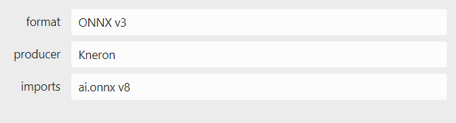

the converted onnx you provided seems not match to our latest toolchain (v0.14):
yours:

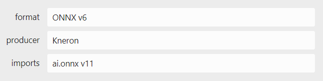

expected:
Could you try the latest version toolchain?
The latest toolchain(v0.14) can successfully convert this model without error.
