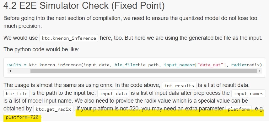

For KL720 BIE simulator need extra parameter "platform=720"
fixed_results = ktc.kneron_inference(input_data, bie_file=bie_path, input_names=["data_out"], platform=720, radix=radix)
its working now, thanks
